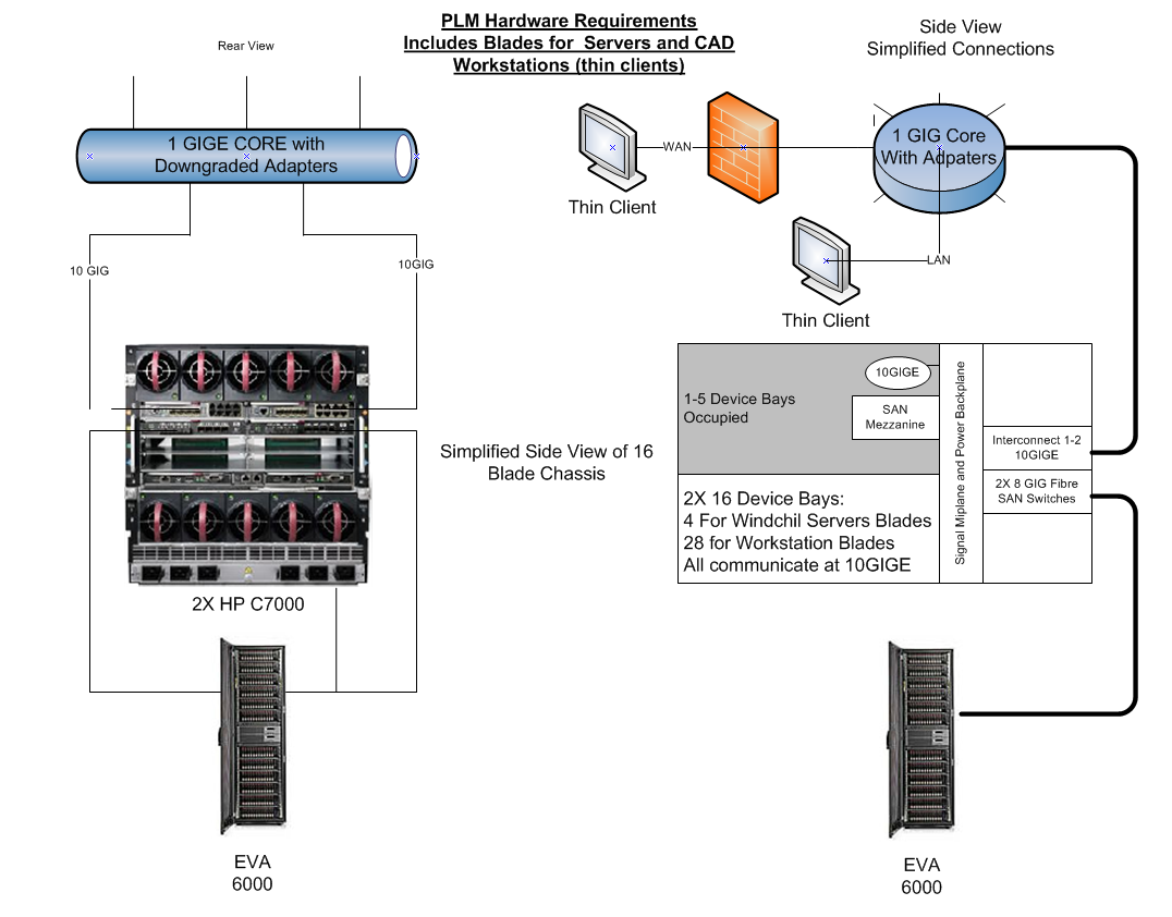

Single master vault with thin/zero clients and graphics accelerators is the best option.
This monolithic physical solution requires:
  • 2X 16 blade chassis with
o   3 physical application servers for 1 production Windchill, 1 production CAD workstation and VM host for test and development
2X Intel 6/8 core 3.0 or 2.7 GHz CPU (possible 12 foreground + 3 background methodservers)
2X 96 GIG or 128 GIG RAM
2X 10GIGE
2X 8GIG fiber for SAN
OS Linux 6.# (ability to have AuFS)
o   1 physical database server
2X Intel quad core 3.0 GHz CPU
2X 48 GIG RAM
2X 10GIGE
Oracle Database Server, (my preference is not to have SQL Server based on poor performance and rebooting)
o   28 Workstation Blades (supports 224 concurrent users/8 users per blade), each having
2X Intel 8 core 2.7 GHz CPU
2X 64 GIG RAM
1X 10GIGE
1X 8GIG fiber for SAN
2 Graphics Cards.
o   Thin client for new systems or USB clients for existing remote desktops.
