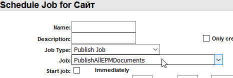

Localization WVS schedule job description
Create possible localization WVS schedule job description, displayed  in WVS Job Scheduler Administration UI.
Example: com.ptc.wvs.common.util.JobDescriptionResource.java
package com.ptc.wvs.common.util;
import wt.util.resource.RBComment;
import wt.util.resource.RBEntry;
import wt.util.resource.RBUUID;
import wt.util.resource.WTListResourceBundle;
@RBUUID("com.ptc.wvs.common.util.JobDescriptionResource")
public final class JobDescriptionResource extends WTListResourceBundle {
   @RBEntry("Publish All EPMDocuments No Representation")
   @RBComment("Description to display for a PublishAllEPMDocumentsNoRepresentation")
   public static final String PublishAllEPMDocumentsNoRepresentation = "PublishAllEPMDocumentsNoRepresentation";
