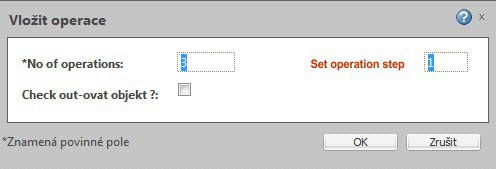

Salut,
when inserting new operations in process plan there is very annoying "auto reorder" feature.
Let's say I want to insert operation between 0010 and 0020 (as 0015 e.g.) using "Insert operation after" command. After standing on 0010 using "insert after" then new operation is inserted as 00020 and every single following operations are automatically reordered Workaround is to always insert new operation at the end of process plan and manually change it to 0015 afterwards.
My idea is to add an option for "operation step" allowing to insert operations in range without beeing reordered.
In my case would work like this: Standing on 0010 operation => set operation step to 1 => insert 3 new operations after
so the result in process plan gonna be:
0010 (not changed)
0011 (newly inserted)
0012 (newly inserted)
0013 (newly inserted)
0020 (not changed/reordered)
4 Comments
GregoryPERASSO
Good idea , but have to be configurable.   My Users are happy of the re ordering
PetrP
My users nuts bcs of reordering 🙂
jgriffin-2
1-Newbie
Good idea, can save time when your operation logic might not follow a 10-step!
