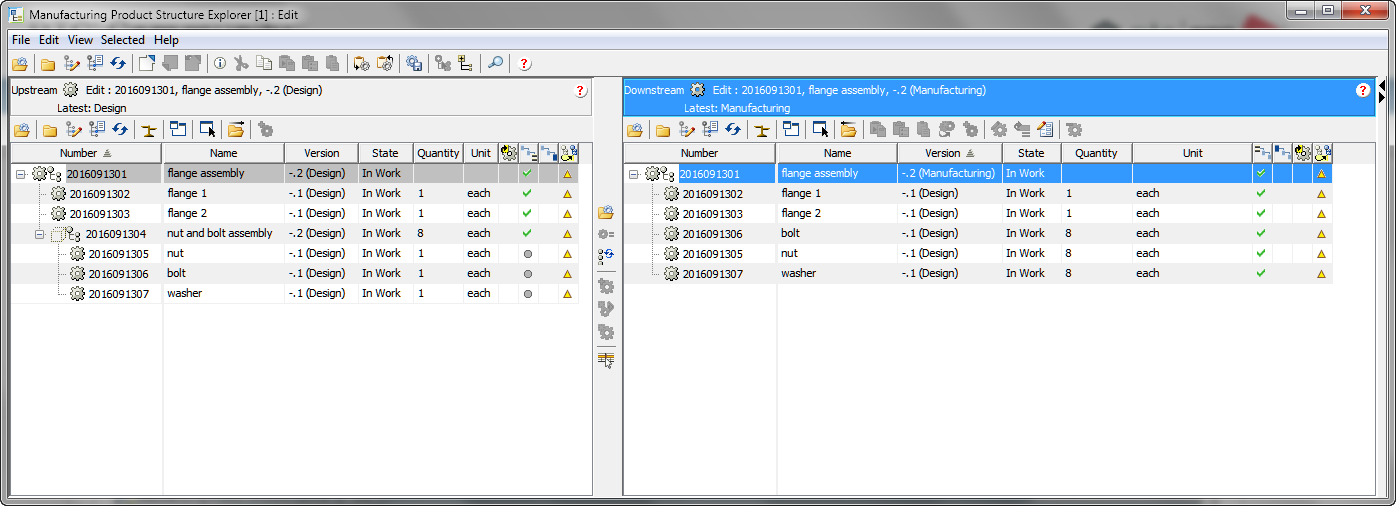

When a mBOM has been created from an eBOM - childs, located under a Gathering Part should be moved up automatically.
Current situation:
Expected situation:

What you are describing is how a phantom assembly works.  I've always looked at the gathering part as in where you have something like a purchased assembly but you need to track the parts in it for design, but in manufacturing you would only see the top level because it is bought as a unit.  Then what should happen is that it should remove the gathering parts from the mBOM.

I only see this ability to work in 1 scenario, as a 1 time effort to allocate the parts to the mBOM.  The problem you are describing doesn't work so well when the gathering assembly is updated and parts are added/removed.  You cannot have those updates to the assembly automatically update your mBOM.  Since the gathering node no longer exists on the mBOM side, any changes have to be done manually.
Question for you Daniel, do you see this as being a 1 time action to roll up the parts, or do you expect it to update your BOM every time the gathering assembly is updated?
