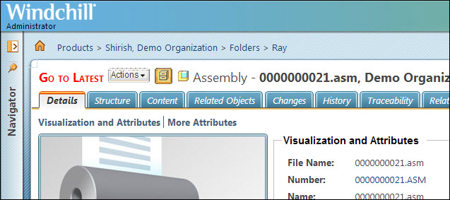

The easiest way to control this is via the CSS stylesheet. In "<WT_HOME>/codebase/netmarkets/css/windchill-base.css" you can add an entry similar to the following:
.infoPage .goToLatest a{
    margin-right: 6px;
    margin-top: 1px;
    color: red;
    font-size: 16px;
    font-variant: small-caps;
    font-weight: bold;
    text-decoration: blink;
Of course the CSS properties and values you choose can be different. The blinking text is probably a bit overboard. I google for blinking text CSS properties and found it might have been deprecated, but not sure.
gmehta
A+ works great.
I guess for it to work I had to add the "a" on the first line. OOTB does not have the "a"
Very simple yet functional solution. No method server restart etc is needed.
***Backup your windchill-base.css file before making changes.
LawrenceS
18-Opal
I think nothing short of a hand coming out of the screen and smacking the user would be satisfactory...although I am not sure what this code would look like.
That being said, the next best thing would probably look something like the larger red text as Shirishkumar shows in the above screenshot.  Very nice.

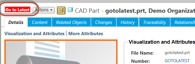

Please disregard my previous comment to this blog. It is recommended not to modify windchill-base.css directly. Instead you can follow below modified instructions:
1. Create your own css file: I have created mycustomcss.css in “<WT_HOME>/codebase/netmarkets/css” directory with the following content:
margin-right: 6px;
margin-top: 1px;
color: red;
font-size: 16px;
font-weight: bold;
2. Register this custom css: Add this custom css scripts to all the pages. To do this by modify netmarkets.presentation.cssFiles property in site.xconf to have the necessary css files included.
<Property name="netmarkets.presentation.cssFiles"
overridable="true"
targetFile="codebase/presentation.properties"
value="netmarkets/css/mycustomcss.css"/>
  • Make sure path specified is relative to codebase
  • Use forward slashes for the path separators
  • You can include multiple css files as a comma or semicolon separated list in the value.
  • Note that order is important, and that the files will be loaded after the Windchill style sheets so they will properly override the default styles.
3. Propagate changes: Propagate above changes using below command:
          xconfmanager –p
4. Execute below command to combine all css files.
          ant -f bin\jsfrag_combine.xml
Note- Please refer Windchill Help Centre for details about Adding Custom CSS Files
5. Stop Windchill Method Server
6. Clear Tomcat and Info*Engine cache
7. Restart Windchill Method Server
Please check video: http://youtu.be/cWOLqtpPOdU
