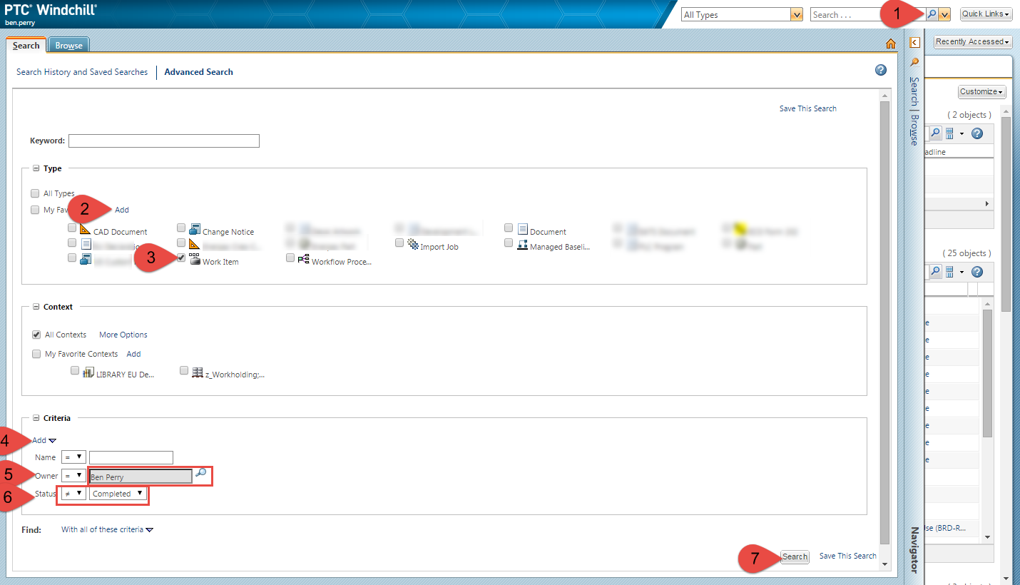

You can do this on a per context level today (Product, Library) on the Task page.  You can also do this today with Advanced Search by searching for Work Item and the doing the re-assign from there.

The task page only shows current tasks and not future tasks in the process that have not been activated in the workflow.  Do you have any examples of how to do the Advance Search for a Work Item?  We also have rework built into the workflow to go backwards to users to fix mistakes.

Brian, the Windchill Calendar can handle delegations to any future tasks.  The screenshot of Advanced Search is shown below, for example.
Criteria: Owner=Ben Perry;Status≠Completed;Type=Work Item;Context=All Contexts

The calendar means I am delegating all of my tasks for all processes.  I would want to more reassign the user in the role for a full change process.  I cannot delegate all because delegation does not honor the resource pool identified in the workflow task and may assign a task to someone who is not trained to do that work.  this would be a compliance issue for us.

Ben,
Thanks for the screen shot of the search criteria.
