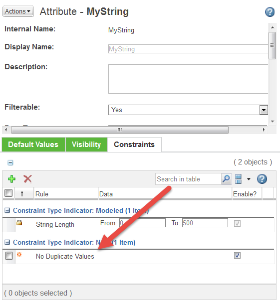

JeffZemsky
A new Constraint was added for Type managed attributes called "No Duplicate Values".  It prevents a users from adding the same value twice to a multiple value attribute.  I am verifying as to the exact version this was added but I believe it was 11.0 M010
