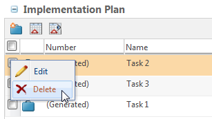

as of now it is only possible to delete the task one after the other -

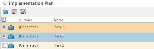

Obtain a possibility to delete multiple tasks at a time. See following; I want to delete Task 2 and 3 at once -

Have you tried adding the list_delete action from "folderbrowser_toolbar_actions" actionmodel to the "changeNotice implementationPlan table" actionmodel?
will probably work
like this, but test it a bit:
<model name="changeNotice implementationPlan table">
<description>Toolbar actions for the implementation plan table on the change notice info page</description>
<action name="create" type="changeTask" shortcut="true"/>
<action name="setEffectivityOnViewPage" type="effectivity" shortcut="true"/>
<action name="viewEffectivityOnViewPage" type="effectivity" shortcut="true"/>
<action name="list_delete" type="object" shortcut="true"/> <!-- Delete -->
</model>

Can't we just add OOTB Delete action to the Implementation Plan table actions and use it to delete multiple Change Tasks.
