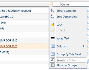

BjoernRueegg
By the way, PTC just released the feature column filtering, also for earlier Windchill versions (It doesn't say which versions.):
For Windchill 11.1 it works wonderful!
Enabled by the property
<!--Column Filtering in Tables-->
<Property name="com.ptc.netmarkets.javascript.tableColumnFilteringEnabled" overridable="true" targetFile="codebase/wt.properties" value="true"/>
