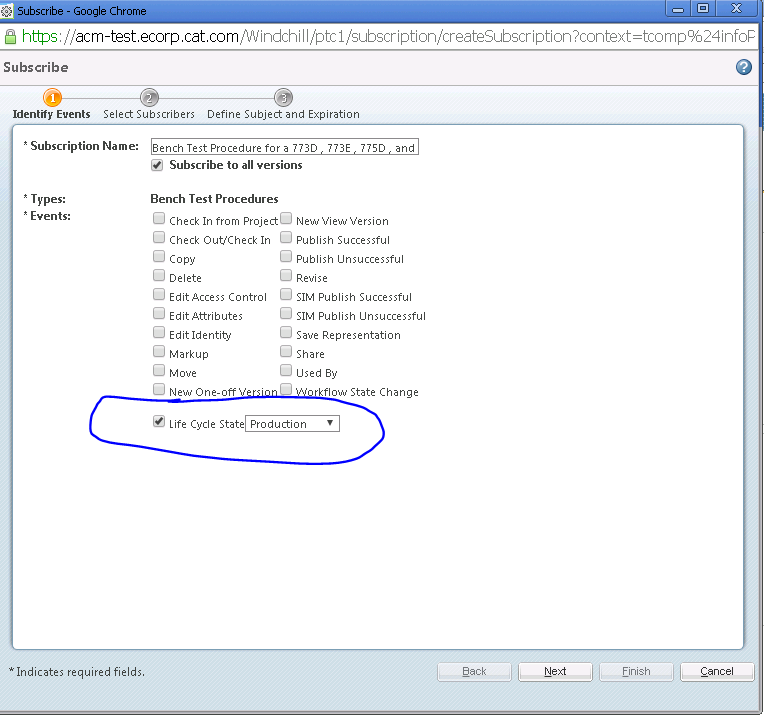

CAT Service is trying to use the Notifications in Windchill to email users when a Media goes from "IN WORK" to "PRODUCTION" state using a Change Notice.  However from the custom Service workflow we cannot emit ChangeLifecycleStateSummaryEvent or LifeCycleServiceEvent.STATE_CHANGE for an object from the custom code.

We need to have this supported in our custom workflow so the users can get their Notification emails when the Media goes to Production state.

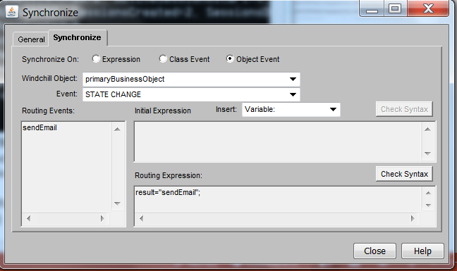

Below is a simplified example of a Synchronize robot that would send an email on the state of the primary business object getting changed.
This Synchronize robot has been customized with a single routing option. The Routing Expression is executed when the STATE_CHANGE event is emitted for the primary business object. TA simple routing expression has been coded to set the result to the desired routing event.

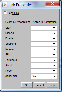

In this example, the Synchronize robot starts and waits until such time that the primary business object changes state. Thereupon it executes the routing expression which in turn activates the link titled sendEmail and triggers the Notification robot. The Notification robot would need to be customized to specify the mail recipients and the subject and content of the email.
Please note that this is a contrived example and is intended to demonstrate the use of the Synchronize robot and Routing Events. You can use the Routing Expression to programmatically select between multiple routing events and decide execution paths at run time.
