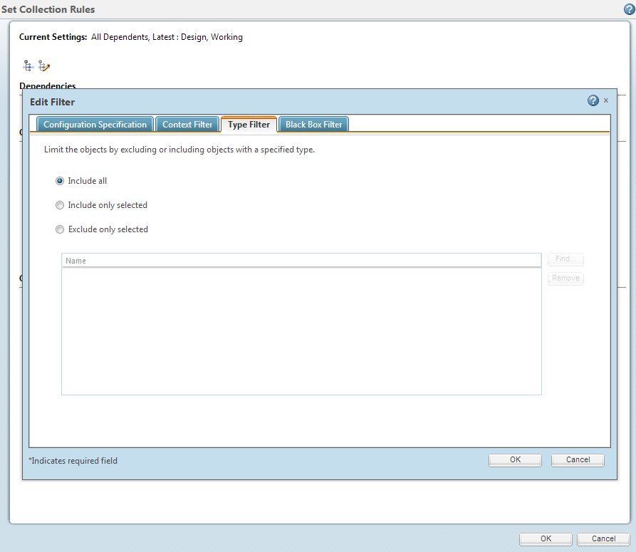

Currently during adding content to Managed Collection (or Package) it is possible after initially selected objects apply collection filters to collect related/dependent objects and include/exclude some of them by context and type.
There is need to filter out only objects with exact Life Cycle State.
I propose add new type of Filter - LC State Filter - to select required Life Cycle State for collected objects.
picture 1: current filters
