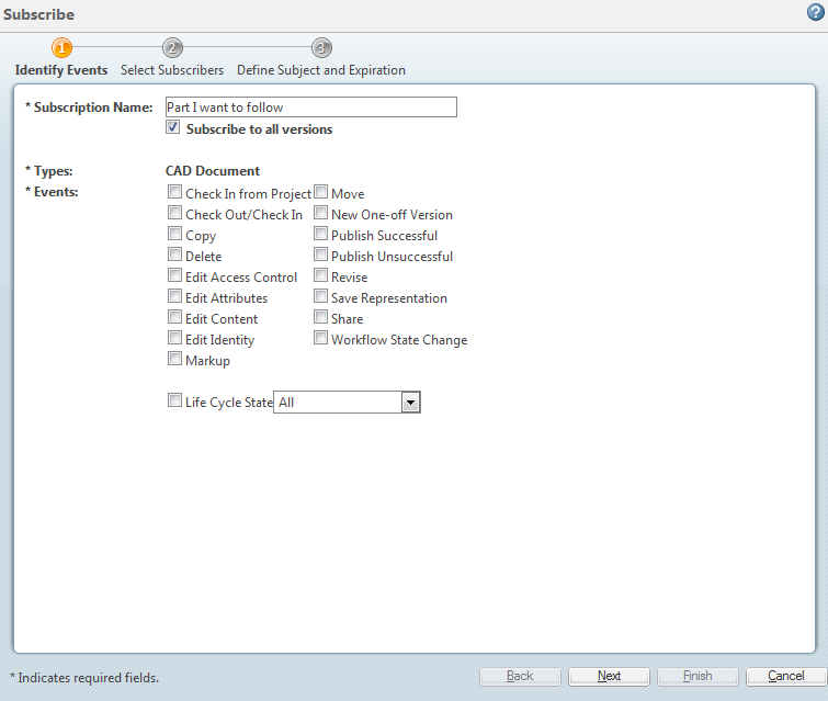

As known from Windows explorer or Sharepoint, user should be presented a dialogue to get notified when a document is checked in again.

Doesn't the 'Subscribe' function already do what you're asking?
asaffari
yes, but I want to get a dialogue presented whenever I open a document checked-out by someone else, in which I could simply request to get notifed when it is checked back in. Doing this via the subscribe function is way too many clicks.
