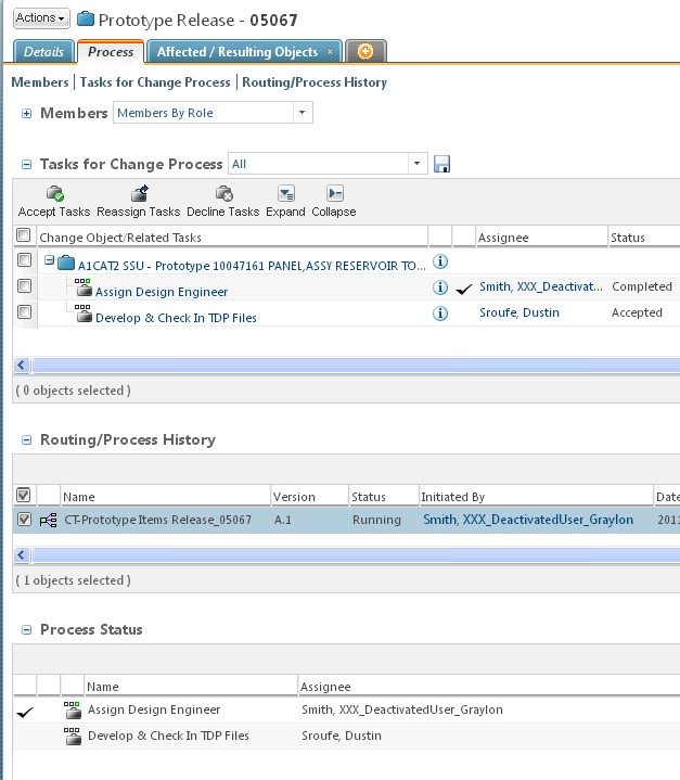

With the major UI changes from Windchill 9.1 to 10.0/10.1, there were some great improvments in UI capabilities. Unfortunately, the page customization (Should be called Configuration) in the Home page is not available in other page types.
As an example, I would like to be able to configure the process tab to move the order of information to have Routing/Process History first but other than Home page, the drag and drop to rearrange the order isn't and available functionality.
Its a great UI capability in the Home page. Make it capable throughout the tool.

As a workaround until PTC makes this you can add your own custom tab where rearranging the order IS possible. This is both possible on individual user level and on admin level. You can even drag and drop the "My Process" tab to the location of the OOTB tab you are customizing.
If an admin configures this and adds all users to a profile it is possible to hide the original OOTB "Process" tab.
