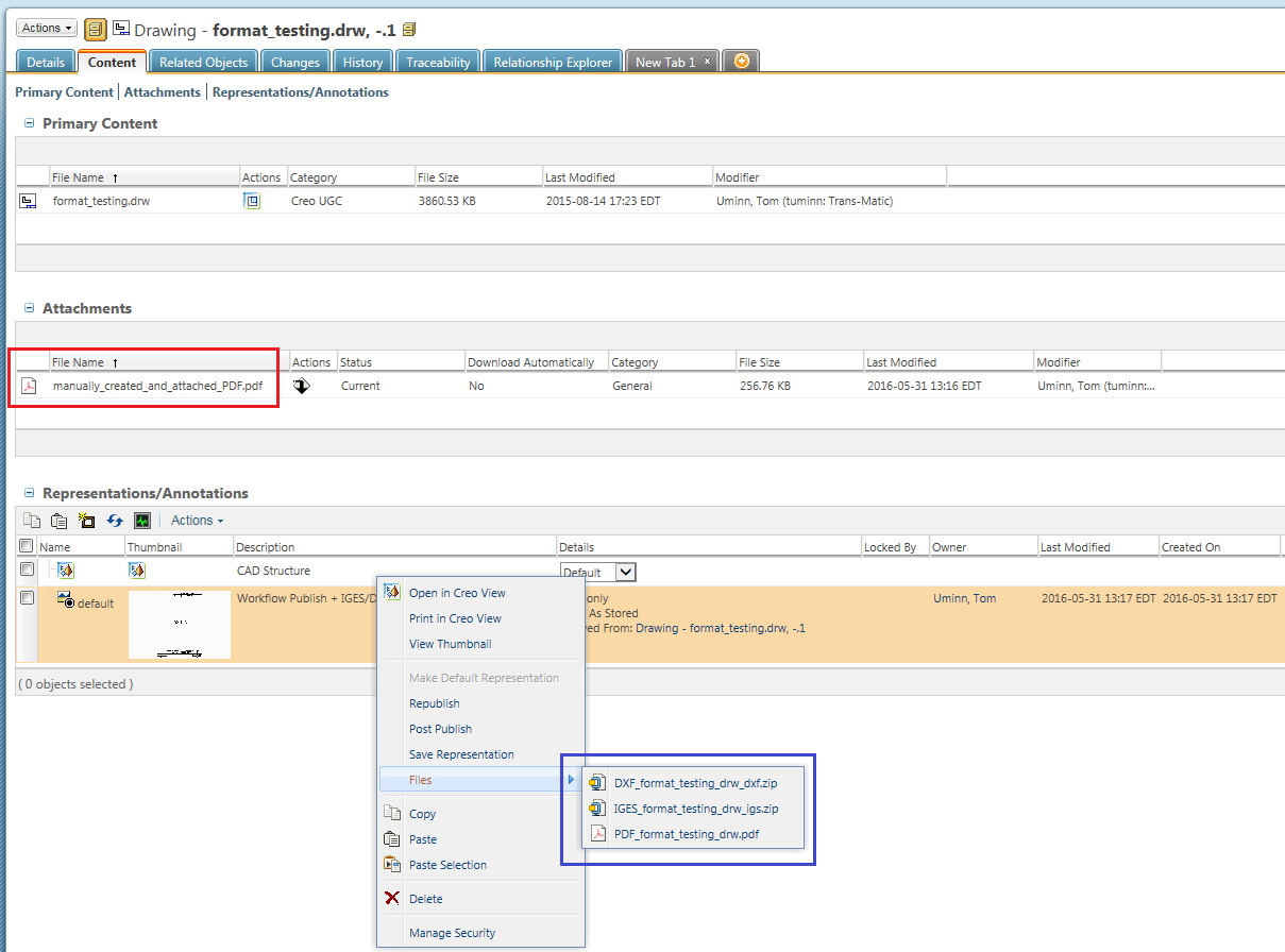

I find it much more clear when the additional files are listed in the attachment overview than in the more hidden representations. OOTB it is not possible to automatically add the additional file types as an attachment.
Also an advantage is that in IE we have the problem that an .stp and . sat are opening in a HTML editor instead of that they are downloaded. When the additional files where in the attachment I was able to click on the download icon.

In the meantime we found out that when you set a program (doesn't matter which one) to be openend when opening a .STP or .SAT then the file is downloaded instead of openend in the html editor. This is probably because a file that is not set to open by a certain program is openend in the editor.
