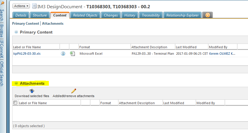

Dear All,
We have slightly different issue here. Our customer wants to see the attachments in the folder browser. We modified the view to include the "Attachments" attribute.
After which we are able to see the attachments icon in the folder view. However, this icon is displayed for documents having NO Attachments as well.
Has anyone faced such issue. Is it a product bug or any issue in our server config.
Your help is much appreciated.
