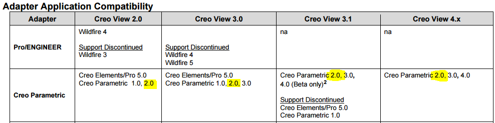

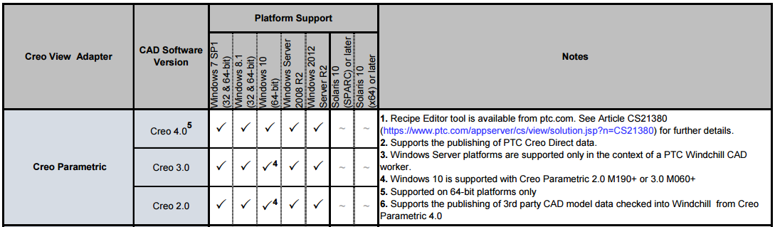

TomU
Lawrence Scheeler‌,
This statement seems odd.
It looks like we cannot install the Creo 3.1 adapters while running Creo 2 publisher because it returned an error when we did this.
According the to the Creo View Adapters Matrix, Creo 2.0 is supported with 3.1 and even with 4.0
4.0 F000:
LawrenceS
18-Opal
Thanks for the Screenshots Tom, I had trouble finding those.  Then I have no idea why it is giving us an error.  I think we are going to try using the Creo Parametric 3 publisher on the server rather than go through PTC to troubleshoot why it is not working with Creo Parametric 2...at this point.  Thanks for your help!
