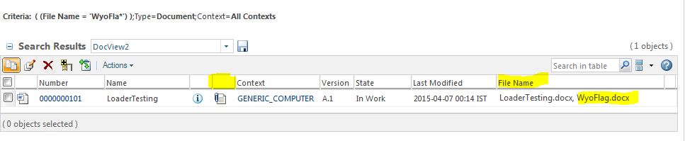

For example, I created a document named "LoaderTesting." Then I added an attachment to it named "WyoFlag.docx."  When I searched for the file name "WyoFlag*" here are my results:
(Highlighted the Attachments column as well)

While it is slightly more usable at 10.2 M030, earlier releases should still have the ability to perform a keyword search against indexed file content, including file name.
