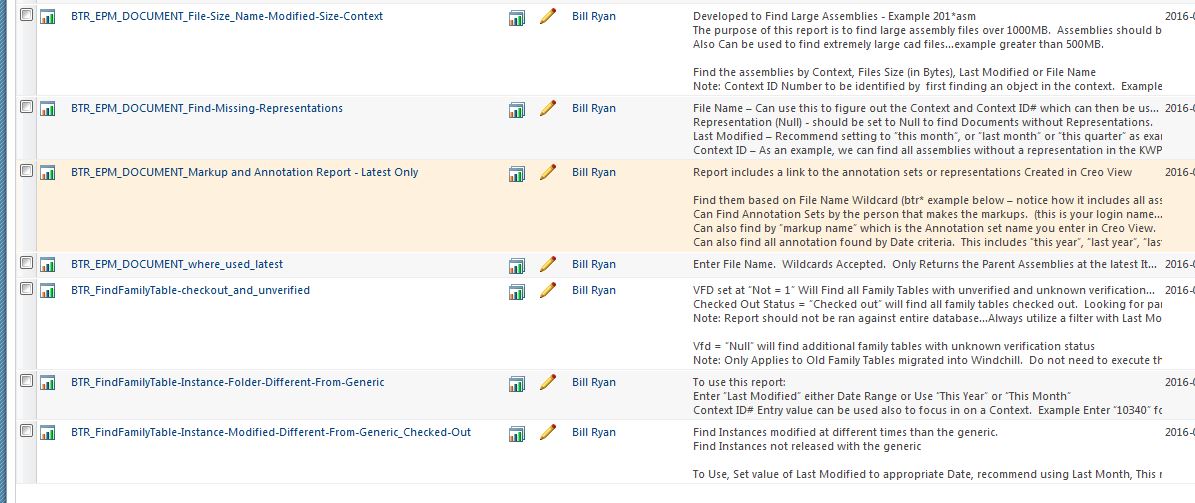

Jeff, I agree that it is already supported, but the steps and process to apply it is very painful.  There needs to be a checkbox type selection or drop down menu like add to workspace configuration where we can easily select "latest only".  The population of reports that utilizes latest for me is about 100%!  I'm sure most customer's want to latest version.  I easily wasted 10 hours in the report creation manipulating with trial and error to get latest to show up in the tables for all the reports below.  I hear that the WC11 improves reporting so maybe they eliminated the steps needed to make the sub-select functions apply.
