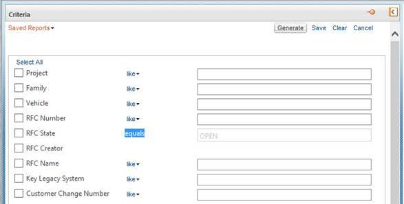

Report Builder: Allow more than one default value for parameters in where clause using 'IN' operator
What is the 'IN' operator for if you can not create a list of legal values?
Default value can only be one single value, even a sub-select will just be considered with the first returned value of the select.
Business Case (here): confine the possible values selectable during report generation for objects attribute "State".

Hi Marco,
Thx for your answer and the link. I knew this valuable resource for reporting alright. Thx for this.
I already tried out what is described on page 56ff but it is not working in 10.2 M030
If you add multiple conditions ....
.... you end up with multiple lines in the report excluding each other, so not finding anything.
And as described in my inital post using a sub-select only the first value will be considered in the report instead of all values returned by the sub-select.

Bertram,
the behavior you have described in the second image started from version 10.0
Before Windchill 10.0, one of the purposes of criteria was to obtain filters.
This is no more necessary.
From Windchill UI you can search an attribute more times with different value.
Try to do the same things with query builder by selecting the same attribute more than once.
