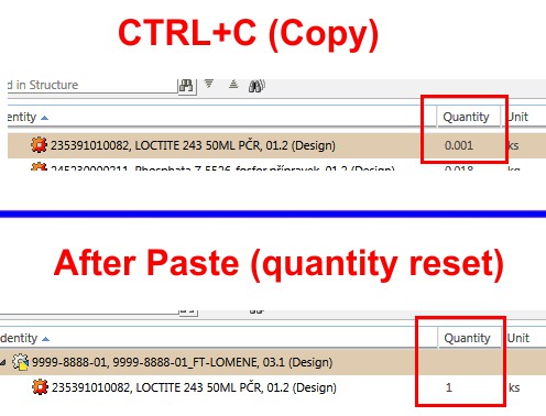

our designers unhappy with twisted functionality in WCH 10.2 when copying WTP from one structure to the another one.
When doing this via browser system always resets quantity and other info. Funny is Java can keep these values.
Hope fixed in WCH 11.0 or planned versions because for us working under Java is just a pain in the ar$e. Java is superslow and Explorer is often opening for a century. Designers want to work under browser only so would be nice to let WCH keep values during Copy/Paste.

Closing as a duplicate of the Product Idea below.  You are asking about Copy/Paste with Usage Attributes which is planned for an upcoming release.
Copy-paste WTParts from one product structure to another usage attributes values are not getting cop...
