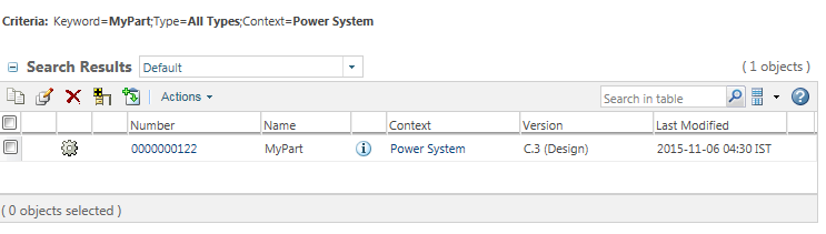

Maybe I'm misunderstanding that bit, but it sounds like this can be controlled setting the Search > Latest Version Search preference to "Yes" (default is "No").
For example:
1. Simple keyword search, default behavior:
2. Advanced search following the steps in your first example (setting the Revision criteria to Latest)
3. Set the Search > Latest Version Search preference set to "Yes" and perform simple search again:
(Results in scenarios #2 and #3 are the same, but in #3 you didn't have to manually set Revision = Latest through advanced search).
On the flip side, if you ever want to see the latest iteration of each revision (the result list in scenario #1), you'll need to perform an advanced search and set Revision = All

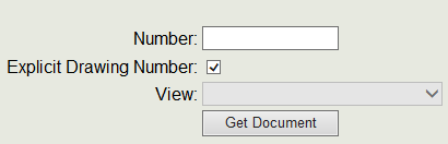

The referenced Ingersoll Rand Simple Search is shown below as another example.  It is intentionally very simple and featureless.  It is intended for people who just need to see drawings, such as technicians on the factory floor.  When the Get Document button is clicked, the content (e.g., PDF) is displayed immediately if there is only one result.  There is no need to show search results, first, if there is only one PDF related to the entered number.
