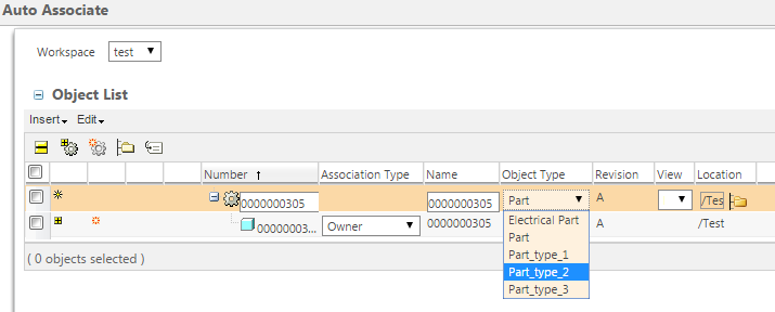

Now: When using auto-associate a default Wtpart type is linked to the object.
Idea: When using auto-associate it will be possible to chose from a list of created sub-types, like it is possible when you manually assoociate Wtpart subtypes to EPMdocs.
I suggest this selection should be simplified even further by providing the end user with a drop-down list.

SteveShaw
Windchill 11 introduces a drop-down list in the auto-associate UI that allows the user to specify the Part sub-type they would like to create as part of this process.  See image below:
