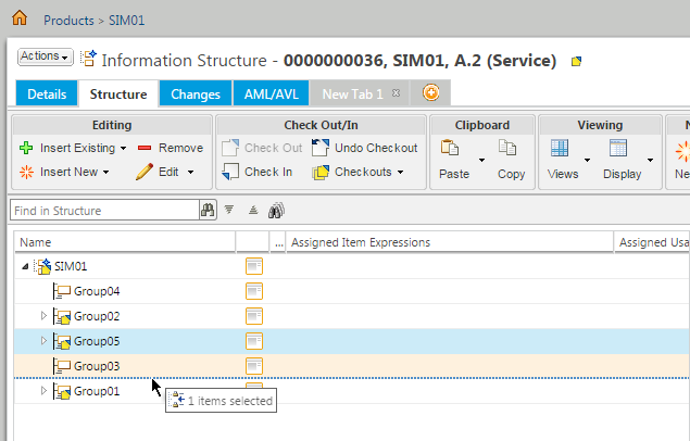

Hi Pushpinder Toor,
Could you please provide more details about the "Drag & Drop" operation in Information Structure? I tried to drag & drop Information Group or Information Element in the Structure tab, but it never works.
I tried it in 10.2 M030 and 11.0 M010, neither version works.
Best Regards,
Brent
fmok
Hi Brent,
Drag & Drop was added in Windchill 11.0. It works for structures that are sorted by Line Number. If you do not see the line number in your IS, you add it from the "Manage Structure Views" action under the "Views" toolbar.
If a user wishes to re-order the structure by another attribute, they are allowed to do so, but drag and drop will be disabled until they re-sort by line number. The key difference is Drag and Drop is a permanent update that impacts all users while sorting by a columns such as name\number is specific to a user.
Note: If you did want to re-sort the view by a specific column and permanently update the line numbers to reflect that order, you can do that from the "Store Ordered Structure" action under the "Display" toolbar.
BrentLi
18-Opal
Hi Rank,
Thank you very much for your reply!
Finally I found the resolution: Refer to Optionally Enabled Features to set "Release.optIn=true" and restart Windchill. Then it could drag&drop the Information Element in the Information Structure.
