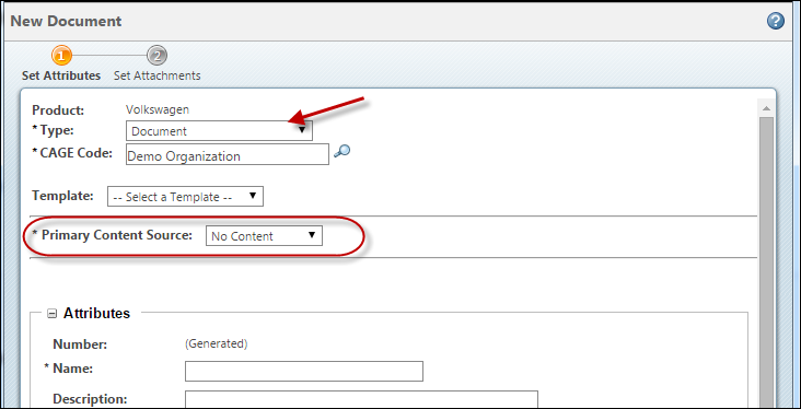

You may able to do this using JavaScript. Using JavaScript I am able to pre-select "No Content" for Document parent type and if type is other than parent type "Primary Content Source" will prepopulate with Local File as shown below:
To do this you can write your own JavaScript function and call with with syntax:
    PTC.driverAttributes.on("afterRefresh",function() {
          setTimeout(function(){ customPrimaryContent(); }, 100);
Where customPrimaryContent is a custom JavaScript function.
Shirish
