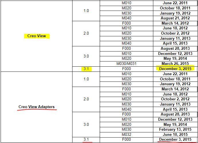

TomU
According to the calendar, both Creo View and the Creo View Adapters were released on December 3rd, but I don't see Creo View in my downloads either.

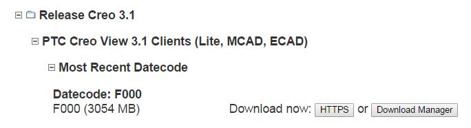

GaryMansell
6-Contributor
I can see both Creo View and Adapters downloads for 3.1 F000

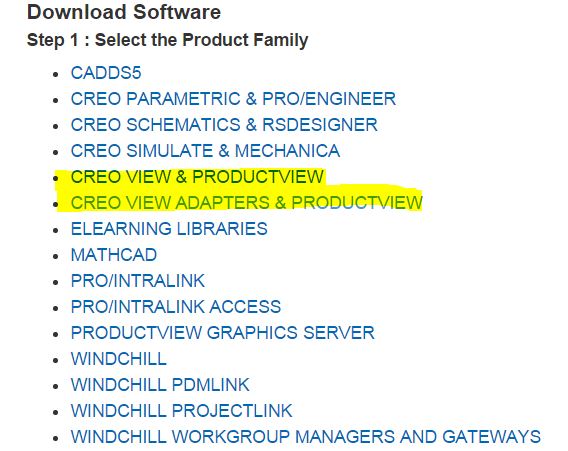

TomU

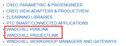

Just out of curiosity, which section is this shown in for you?  The only place I have the Creo View (client) listed is in the Windchill sections.
GaryMansell
6-Contributor
Could be that I access an EU Content Distribution Network server and the US one has not been updated properly...
GaryMansell
6-Contributor
No - wrong location, they have a different download location than Windchill
TomU
Ah, maybe that's why.  I do have the Creo View Adapters section but not just Creo View.  I don't actually own the paid version of Creo View (MCAD), we only use the "Lite" version that comes with Windchill.  Interesting.  Thanks!

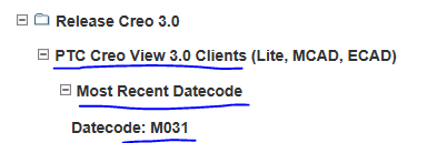

RandyJones
Same for me. The Creo View client only shows in the Windchill sections and the latest showing in mine is 3.0 M031.
GaryMansell
6-Contributor
Yes - that would explain it, Creo View 3.1 comes with Windchill 11 and that is not out yet.
