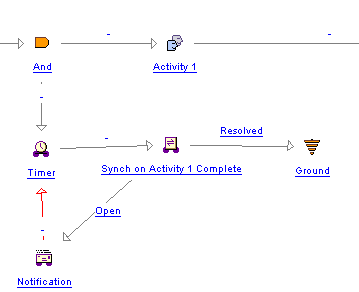

There should be a scheduled task tat loops over all running workflows and checks for all running workitems older than 1 year and sends an email to those users to take care about this.
After running this report the execution time should be stored so that the report can be run next time for all workitems bedinning from this time.

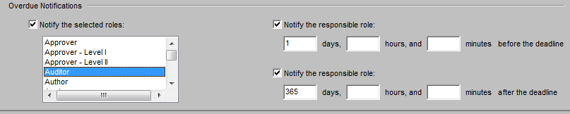

Taking a quick glance at the workflow processes available and I'd bet that it can already be done.
Within the workflow task there is the ability to notify X days after the deadline. That could be set to 365 days. I don't think that would repeat the warning another year later, so perhaps less than you were hoping for.
There is also a Timer robot that could be used in conjunction with AND, OR, Synchronize robot and a Link Loop. Something like what you're asking for would look like this.
When the workflow comes into the AND node it both starts a 1 year Timer and starts the Activity 1. After a year the Syn on Activity 1 Complete fires off and checks the status of Activity 1. If Activity 1 is resolved, it ends there at the Ground. If not, it sends a Notification (email message) and starts a new 1 year Timer.
I don't know what the necessary properties or expressions would have to be, but all this is out of the box so it shouldn't be too difficult.
