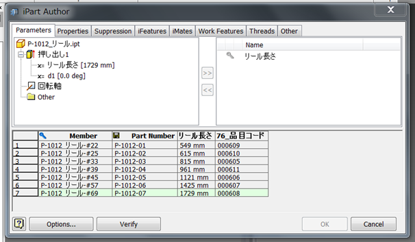

For example, in Inventor's generic parts and instance parts configuration, the item to make the file name in the table can be decided by the customer
However, in Windchill, only the member columns in the table can be handled as file names
Windchill can not correctly update these parts if the customer configures generic parts and instance parts by setting file names except for member columns
My customers decided to fix all the parts over a month and a half in order to adapt such parts to Windchill's specifications
If CAD can set the column to be the file name in the table, unless you can do the same setting in Windchill, such unnecessary change will occur
