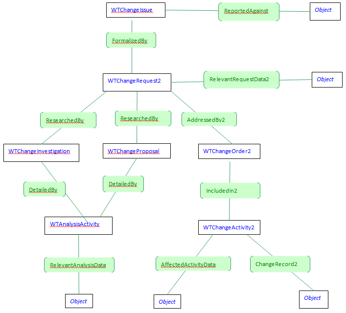

We can summarize the data model of changeobjects as follows :
We can quickly have many objects linked to a change request.

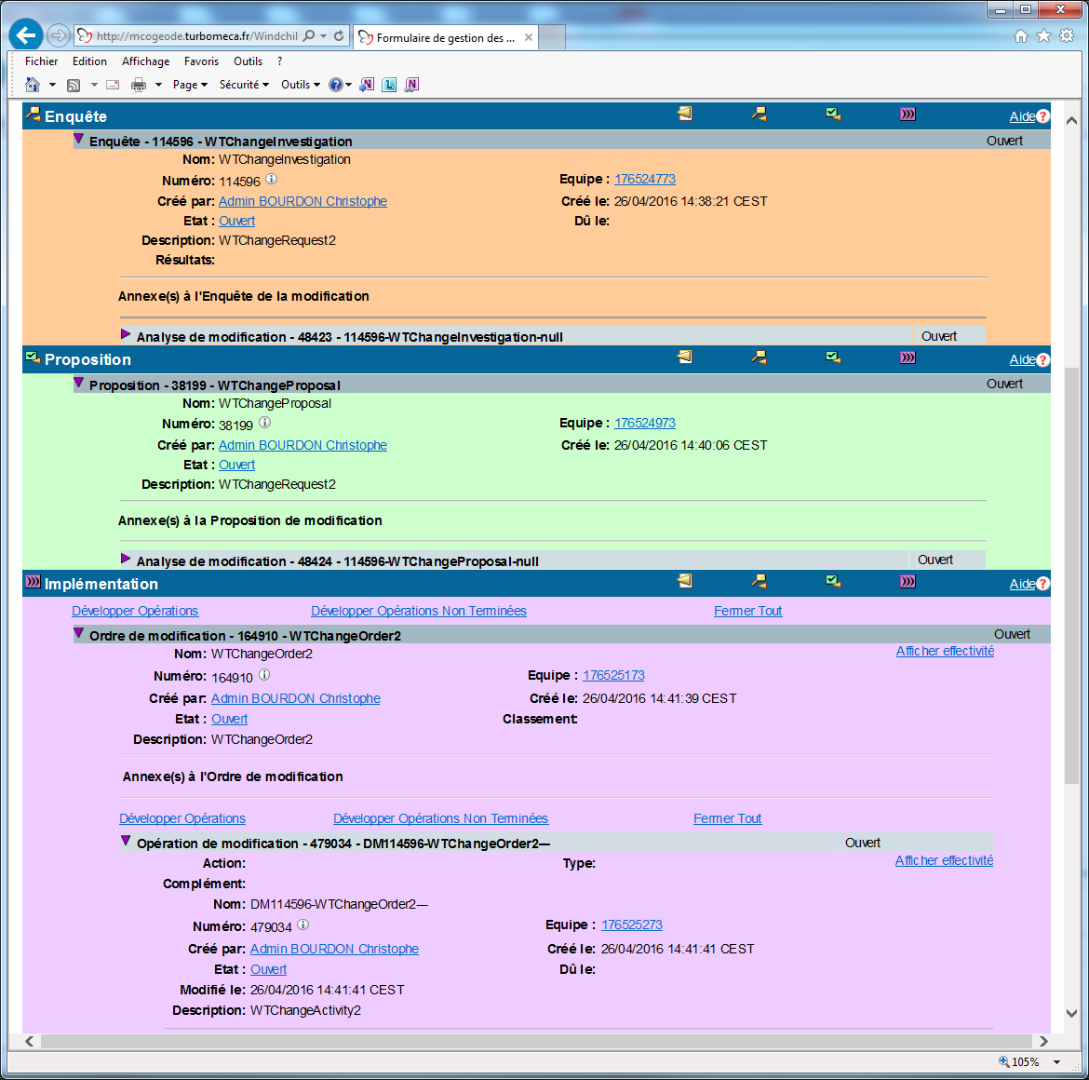

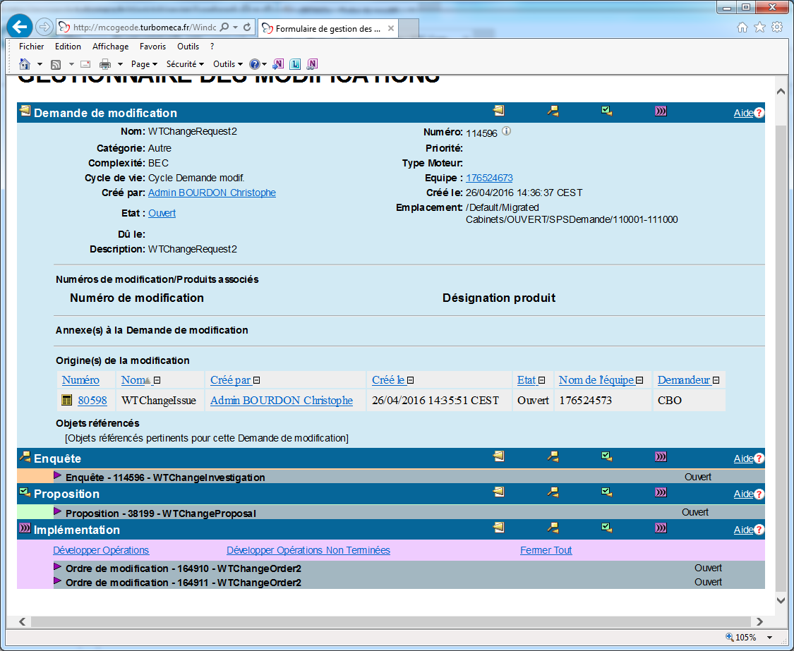

In Winchill 6, we developed a customized page that looks like the following :
Every level can be developped :
We kept this page in Windchill 9.1
