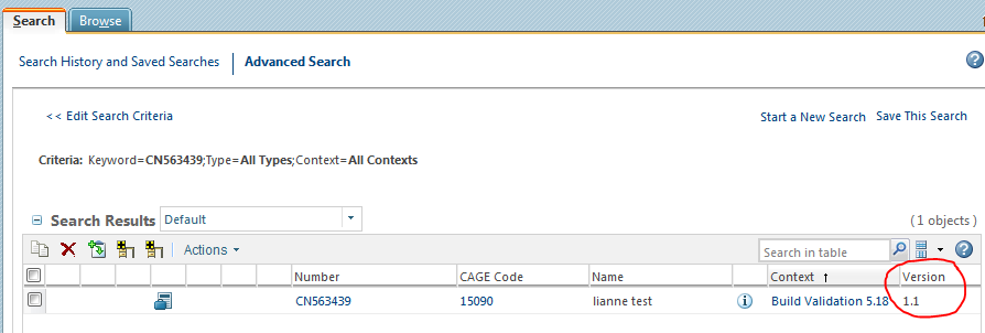

Could there be version/iteration control on CNs/variances.  It is a bit confusing to users where if you searched for a change object or even looked within the product's changes folders, you would see the change object's version (ex, 1.1, 2.1).  Yet within the actual change object there is no iteration. If version/iteration control is not offered on change objects, why do you display it as a Version on searches and folders?

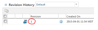

The preference is "Change Modification Tracking."
With this preference set to Yes, one sees Change Objects with Revisionsf (some times column says "Version").  Revise also shows up as a user action, depending on Revise Transitions in the change object's Lifecycle Template.
Under History, Revision History, one can see / access each Revision.
Edit changes the current Revision, no Iterations.

It doesn't allow for Versions (ex 1.1, 1.2, 1.3, etc).  Users want to see the change object iterate when they change it (prior to being approved).
We are using 10.2 and our Change Modification Tracking preference is set to Yes.
Iterations do not display on the actual object but does display when you do searches and within folders.
This is what is confusing to the users.
