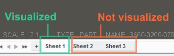

I have a request regarding DRW visualization:
Current Windchill version works with only first sheet of drawing and it is not possible to see other sheets visualization.
We want to see other sheets as well and need them for a future use in print etc.
Think shouldn't be a prob to add listing on detail page and see every sheet after all of them visualized. Would looks like this:

The thumbnail is tough to read for a drawing, but it can give you a quick understand of how many sheets it has and if the one you're looking for is included without opening multiple drawings in CreoView.
PetrP
Main purpose is to be able use every sheet (visualized thumbnail) in a print under MPMLink.
Nowadays I have to attach 10x DRW to get 10 outputs. With this function can have only 1x DRW (including 10 sheets) to get the same result.
In general don't get the point why only 1 sheet is visualized and others ignored. When WVS opening DRW to get visualization shouldn't be such prob to take all sheets...
