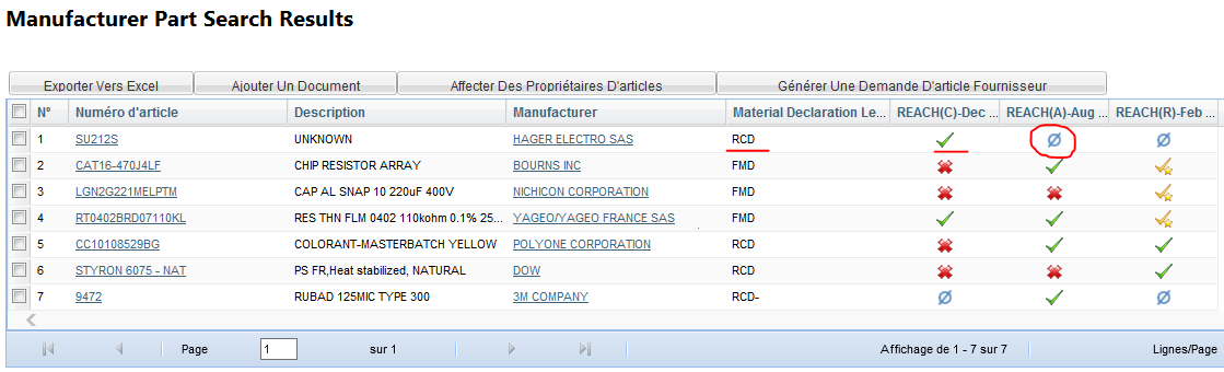

Considering that the REACH Authorization list (REACH(A)) is by definition a SUBSET of the REACH Candidate list (REACH(C)), we expect WPA to deliver a REACH(A) verdict based on the REACH(C) verdict. This is today partially addressed:
  • For a Full Material Declaration (FMD or IPC1752A class D), WPA computes a REACH(C) and REACH(A) verdict
  • For a Failed Regulated Compliance Declaration (RCD or IPC1752A class C) with SVHC in the REACH Authorization list above 0.1% threshold, WPA computes both REACH(C) and REACH(A) verdicts
  • But for a Pass RCD, WPA does not compute any REACH(A) while from a business perspective it should be a Pass REACH(A)
    Is it possible to change this current behaviour so that WPA computes a PASS REACH(A) when a RCD has PASS REACH(C) ?
