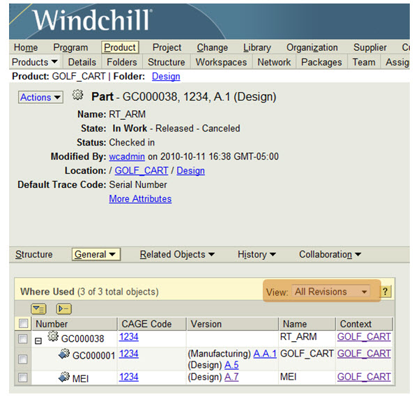

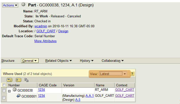

The Part Where used table has support views that show all or Latest for some time.  Here are some 9.1 screenshots

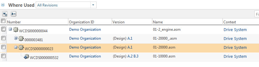

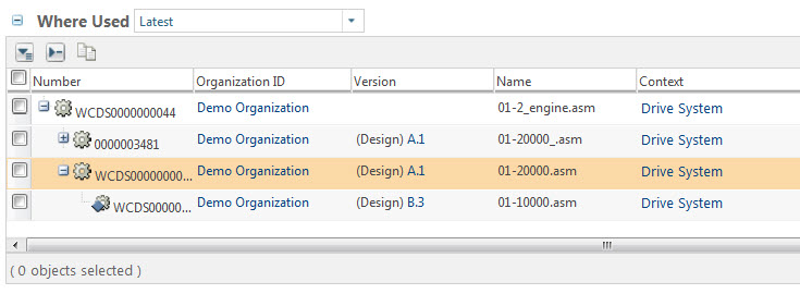

To add some detail for the Part Where Used - it looks at the usage link relationship between the part and its parent and navigates.  It only looks for the latest iteration on a revision for each revision.  The All Revisions view will return all latest Revisions where there is that usage link.  The Latest just the Latest revision, latest iteration result.

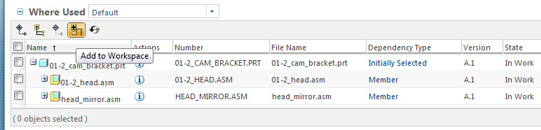

Per your other question - on the CAD Where Used we do support Add to Workspace.  For the Part Where Used we do not support that, but we do allow Copy from the table (Right click).  With this the user can Copy/Paste to Check out to add the workspace (I know - not quite as elegant)

in 10.  Where Used for WTpart does support Latest All Revisions but not add to workspace
WHere Used for EPM (CAD) does support add to workspace but not Latest, All Revisions.
