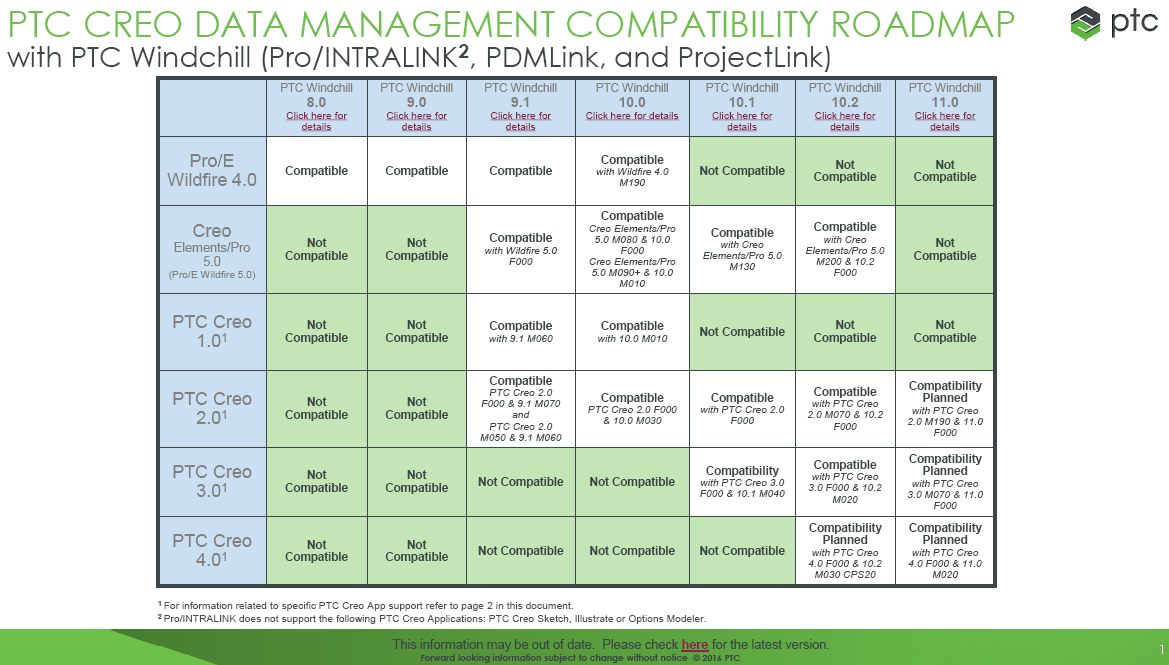

Pricol Ltd is the major global manufacturer and supplier of automotive parts,auto components and automobile accessories to the leading OEMs.  We have used PTC products like Windchill 100+ licenses and Creo nearly 300+ licenses from 2001 onwards.  We have recently upgrade Windchill 10.1 with the date code of M030 on 2013.  In this we have started CAD integration with Creo version of 2.0 as per the Windchill 10.1 M030 software matrix.
We are unable to use the Creo version 3.0 with new date code even though this is the PTC products.  We struct to implement the new version of creo in our organization, if we implemented CAD integration will not taken place.  Missing uniformity of software version across plants.  We have seven plants in India.

Creo 3.0 is compatible with Windchill 10.1 M040.  I doubt PTC will go back to make it compatible with M030.
BenLoosli
23-Emerald II
As Steve has shown, there is a very strict interdependency between versions/builds of Windchill and Creo. It is very important that whomever is doing your upgrades keeps these relationships in mind when doing the upgrades.
Windchill 10.1 m030 was released in January 2013. Creo 3 f000 was released in July 2014.
How do you expect Windchill to communicate with Creo when they are not in sync with the interdependency internal code?.
