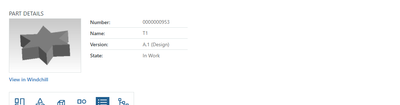

Hi @vcavic
Per the information in the case, Navigate functionality does not allow the ability to add additional attributes to the part details section in the View Part Structure App. To request this functionality, you may post an idea on the ThingWorx Ideas board.

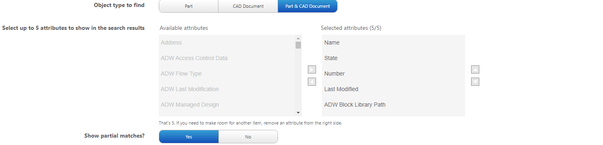

The Administrator can specify up to five attributes from the attributes list on the tailoring page that will be displayed on the Part Details page.

Hi @barko, i have Administrator Account. But i can't find these settings. Is that in Edit Collection or?

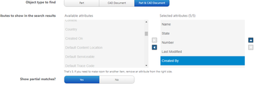

You are at the right place. On the left are available attributes, which are the results of an attribute query that is is already included in the OOTB Navigate. On the right are the (up to) five attributes that have been chosen to be displayed.

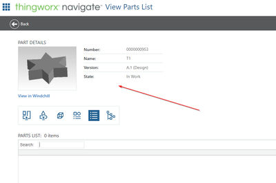

It is possible that your browser is pulling a previous page from cache. Clear your browser cache, or try with an Incognito session so you are sure you are getting a fresh page.

This has the appearance of a bug. You should file a case with Tech Support to investigate this.
