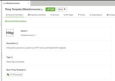

Do I need Navigate license to use the below connector?
/VR
CS_9946173
(To:Velkumar)
Hi @Velkumar
If you make a connector from that template it will not require the user have a Navigate license to use it.
