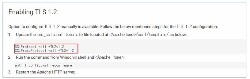

When applying Windchill Authentication in Thingworx Navigate,
Windchill's TLS version needs to be set to 1.2 for the Odata Connector and Swagger Connector to function.
However, Windchill interfaces with other systems where only allowing TLS1.2 is not feasible. Is there a way to allow both TLS1.2 and TLS1.3 in Apache HTTP Server and ensure Thingworx Navigate's connectors also work?
I tried the following configuration, but it resulted in a handshake error on the Apache server.
SSLProtocol -all +TLSv1.2 +TLSv1.3
SSLProxyProtocol -all +TLSv1.2 +TLSv1.3

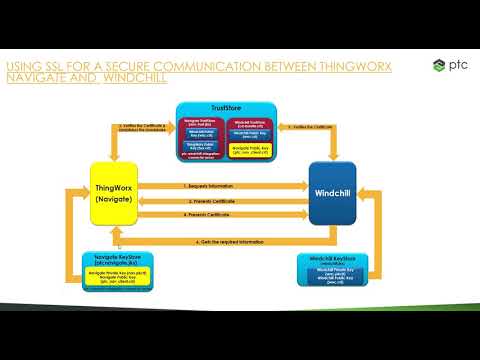

Expert Session: Navigate - SSL & Windchill Authentication Host: Arshad Imam - PLM Product Technology Lead Description: This in Expert Session will take you through a step-by-step approach for configuring authentication between Windchill and Navigate with SSL. Agenda: . Overview of SSL ...

Thank you for your reply.
The guide in the link instructs to configure Windchill with TLS 1.2. In my Windchill environment,
setting it to TLS 1.2 works fine.
However, since Windchill connects to other systems using TLS 1.3, I cannot set it to TLS 1.2 only.
