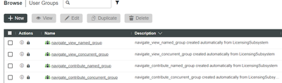

I have 10 licenses ptc_navigate_author_named. But the problem is that I can't use any license
If I see the User Groups, I have not a group "navigate_author_named_group. This group should be created automatically from LicensingSubSystem, is it right ?.

The 4 license groups you see are the only licenses groups created in Navigate. Other licenses such as the author or adk licenses are paired with the view_named licenses, so the first n number of users assigned to the ptc_navigate_view_named group, where n is the number of author licenses, receive the functionality provided by those author licenses.

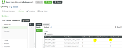

I have bought 12 licenses "ptc_navegated_author", 10 licenses "ptc_navigate_contrib_named" and
4 licenses "ptc_navigate_view_named". In total 26 licenses that should be used with Composer (Navigate).
However, I can only assign 20 licenses to users. Is there any synchronization that I should do between Composer and AD? or between Composer and Windchill?

With your 10 ptc_navigate_view_named and 10 ptc_navigate_contribute_named licenses, you may have up to 20 users licensed to use the OOTB Navigate view apps. 10 of these users may also use the MyTasks app. Since these are named licenses, they are dedicated to these specific 20 users. No more than these users may access Navigate using Navigate licenses until additional licenses are purchased.
Up to 10 of the 20 users defined in the previous paragraph may be able to create data in Windchill with the Author licenses. It is not clear to me yet how these are assigned, and I will continue to research it. For ADK licenses, which also do not have a separate license group, they are assigned to the first n people to be assigned a ptc_navigate_view_named license. This happened automatically and there was no separate license group where you could assign them. This may also apply to the Author licenses.

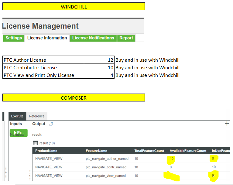

R&D has confirmed the information in my previous reply. They have also provided the following graphic explaining the functionality of the Windchill licenses.
Thank you very much for the reply.
But I don't understand why licenses between Windchill and Composer (Navigate) are not synchronized. In total I have 26 Windchill licenses purchased but I can only use 20 in Composer (Navigate).
There are 6 users who cannot use Navigate.
Thank you very much for your help, it is really valuable.
Have a nice day.
The licenses that you list in Windchill are actually Windchill licenses that provide the Windchill users some access to Navigate. They are not Navigate licenses, and do not show up in the Navigate license management subsystem. They DO show up in the Windchill licensing system. Those are two different things. The contributor license and the view and print only license in Windchill will grant those capabilities to Windchill users. That is managed through Windchill. Those users can be different from the 20 users that are licensed in Navigate. How you actually use the Windchill licenses is probably a question for the Windchill board. I don’t have any interaction with those licenses.
