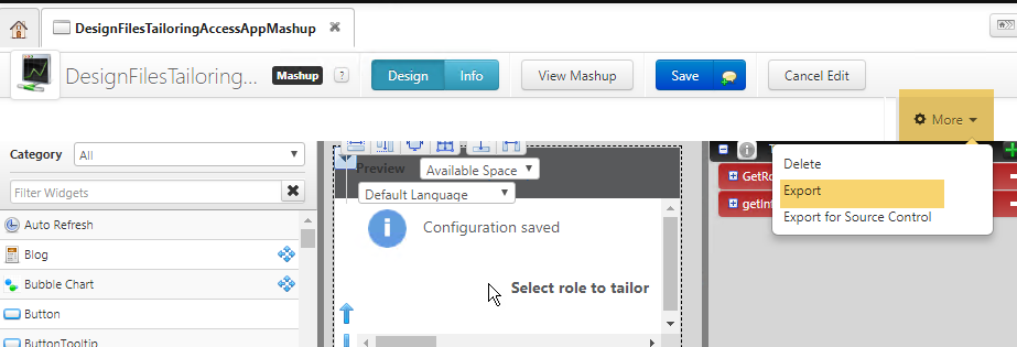

Hi @hselarka,
Thanks for your reply.
Can you please help me out on how to export the entities ? I mean, which all entities to export. How to export all the custom changes made in Navigate ?

HI @akshaygt,
You can export the entities that are customized through ThingWorx Composer UI.
