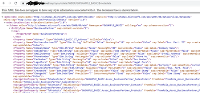

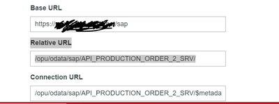

Another modification :
trying to modify URL's
I got 401 Unauthorized
Although I can access the URL from the browser.
Any suggestions?

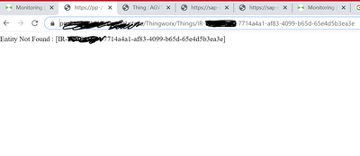

in fact, the Integration runtime is connected but when I tried to debug the issue I got this
Entity not found !!
the entity is correctly created in Thingworx as you see
IR Logs :
first error : unable to dispatch the entity !!!
I'm confused about the main cause of this issue.
