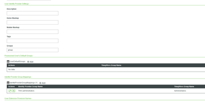

Do you have SSO configured? If you are using an SSO Authenticator and a mapping of the group attribute.
Like in this example?
If the user doesn't have the appropriate group listed in their group "attribute" (in the SAML assertion) the user will get removed from the appropriate group.
One other idea that might also affect user priviledges and groups is users in ThingWorx are case sensitive.
Depending on your authentication method it could be that a user is authorized correctly even if they sometimes write their name in different captialization (e.g. Username vs. username) - ThingWorx would create two separate users in this case with different access rights.
Not using SSO here. This are local thingworx groups. I've manually added them in Composer. Not an issue with user login though I know that issue well.  When I checked group, they were not there.
Thorsten relayed the most common cause of this issue, but it is associated with the ThingworxSSOAuthenticator which is only active when EnableSSO is set to true in platform-settings.json.. ThingworxSSOAuthenticator will reset users group memberships to match those in the LDAP Directory Service if the User Modification Enabled box is checked. That also means that they will be removed from any TWX group that does not also occur in the Directory Service.
