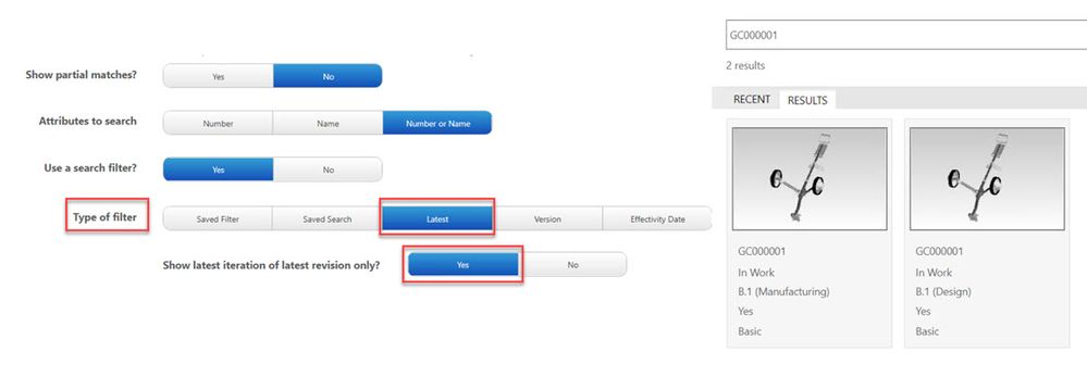

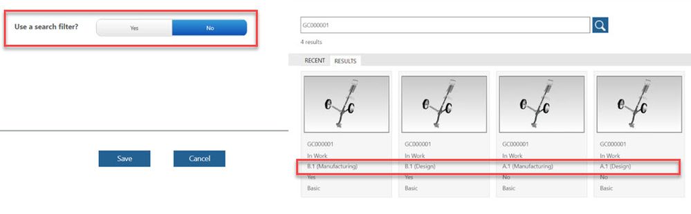

Hi Rick,
Here's an example of Tailoring in Navigate for Displaying All Versions and displaying only Latest :
1. Show all versions :
2. Show latest iteration of latest revision only :
Regards

rleir
(To:Arshad)
Thanks Arshad @Arshad for the screen shots, because with TWX Navigate a screen shot is better than 1000 words.
We will generally choose 'latest version', and the user will want to see 'latest currently existing version'. That is why I talked of re-checking every N minutes, or re-checking when you select 'Recents'.
If you select 'All versions' you will still not see the latest currently existing version (please correct).
