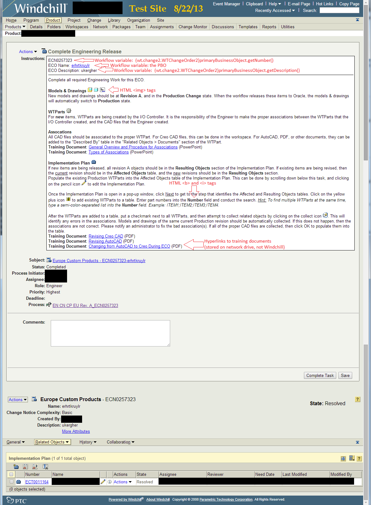

Group,
I am looking for a collaborative discussion & maybe "best practice sharing".
I have been constantly working on Change Management workflow devleopment in my company for 2.5 years. I thought I made these workflow instructions look pretty slick with variables showing up here and there...HTML formatting...etc, etc. Finally a few months ago...I think I went overboard. I reached the 1333-character limit in the workflow Instructions, as outlined by CS61259. My rendered workflow assignment is shown in the screenshot below. Perhaps too much detail in the instructions that should be offloaded to separate training document?
What I'm looking for in this discussion are use cases of workflow assignment modifications & customizations. What are they? What have you done to render good-quality instructions for the users read & understand, and how?
Just looking to share experiences for some users to pick up on that other users haven't thought of before. And along the way, maybe some of you have thoughts about how I can clean up my own instructions so users don't have a book to read when they click into one of my workflow assignments.
Note: Pictures are worth 1000 words. Posting pictures of the renedered task like I did below is great, if you can.

BenPerry
(To:AL_ANDERSON)
Al,
Very cool. Embedding frames is one of the things I had thought about.
But then I thought an iframe that stored instructions that could be dynamically changed might not be the best for our business. Sometimes users would like to "go back" and see what the task looked like to the user 3 or 6 months ago, say. If the iframe source was changed after that...then when looking at the user's task from 3 or 6 months ago would render the current instructions instead of the old instructions.
Nonetheless, that should not rule it out as a possibility. It is possible that the iframe source is never changed. Instead, when the instructions need to be changed, create a new source for the iframe instead of updating the existing. Then modify the workflow to point to the new new location of the iframe source. Using that practice would result in displaying the correct instructions as the user saw them 3 or 6 months ago.
Thanks for the input, Al! This is very beneficial.
