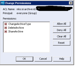

Hello Markus Kiessling‌,
I think you are not aware of the permission configuration for archives. It shall be possible to restrict the user/groups from "sharing the archive".
Just open the Admin Client ==> Navigate to "Configuration Management" ==> Permissions ==> Archives
Now just right click and "Create" and select the sub project under which the confidential members are available.
Now just deny the access as you require,
This should work.

Hi Sathish,
thank you for your reply.
We already use Archive-ACLs. But unfortunately these permissions do not fit to our needs.
We want to prohibit navigating though the archive.
Navigating through the archive shall not be disabled for the whole repository, but on a user defined project level.

Hi Markus Kiessling‌,
Ya yes I agree your point. There is no way in preventing from navigating the archives.
But I confused why its actually needed , because even-though they could browse, its not possible to read its content (by adding the archives) / duplicate the archives. Anyway its not hidden, but somehow its protected. Its just I thought.
