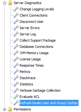

I agree with that idea, but with respect to your hint a more easy reload function of all access groups (like as part of the "Refresh Realm User and Group Caches" would be very helpful in addition..
