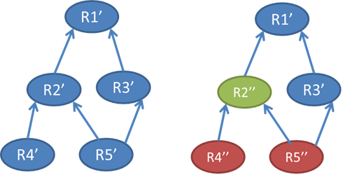

Traceability is not typically a significant field. If a trace is added or removed, then unless the requirement text is also changed, the traceability will be incorrect in the versioned document - this is unacceptable to many of our users. The traceability cannot be made significant without massive downstream impact. If there was a requirement with 5 requirements tracing to it and then 5 requirements tracing to each of them then a trace change at the top requirement would cause suspect flags to be created on the child requirements, which would then cause suspect flags to be created on the requirements tracing to them. This would ripple through the requirements marking them all as suspect. If you then cleared a suspect flag then that would also be considered a significant change and would cause all downstream requirements to be marked as suspect again.

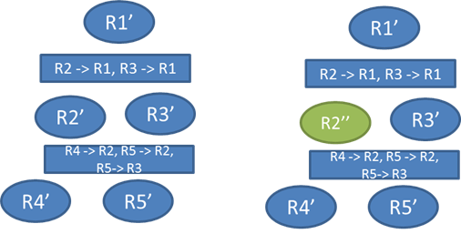

A change to R2 causes updates to R4 and R5 just for traceability. If there were requirement below R4 and R5 then these would also be modified.
A better solution for versioned documents is needed. One possible solution would be to store the traceability between versioned items separately to the version items themselves, otherwise changes to the traceability cause new versions of the items to be created. You could then create a release with version X of the parent document, version Y of the child document and version Z of the traceability between them. This approach would allow you to update the traceability independently of the requirements themselves. If you could do that then you could update requirements without affecting the traceability and also version non-significant fields without any downstream impact.
