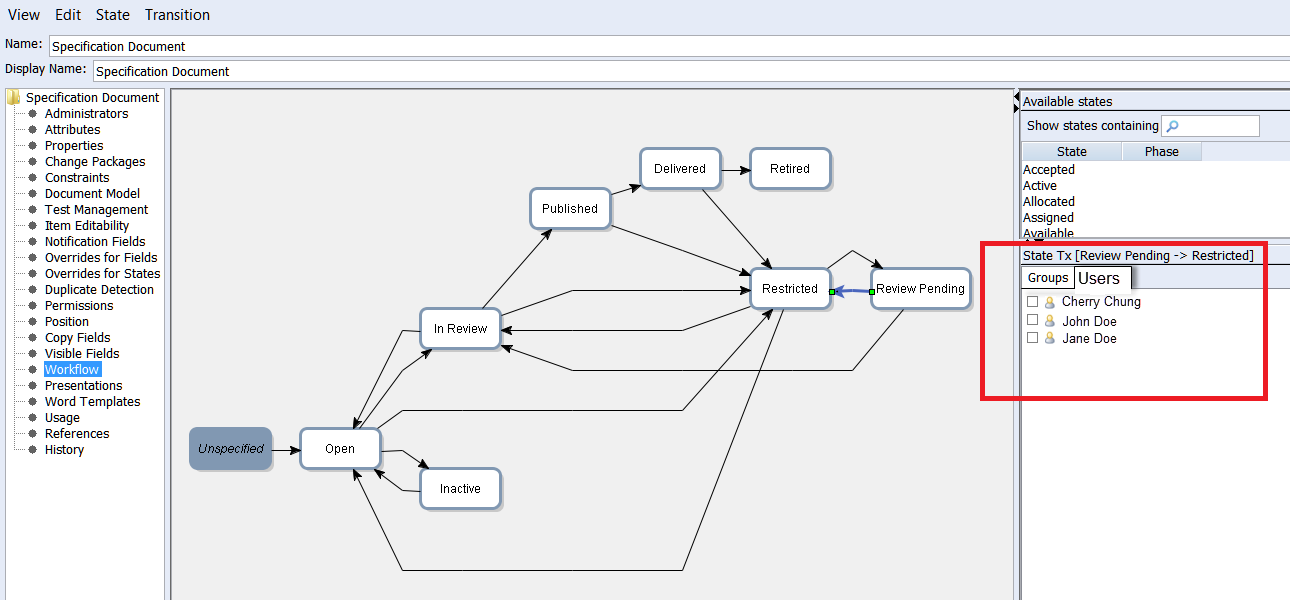

I want to set from State Tx [A state to B state] restrict to Assign User

         I'm not sure I have understood your request. I assume you are asking for an ability to include individual users? Have you tried Dynamic Groups?
I have included a representation on what I think you are requesting, let me know.

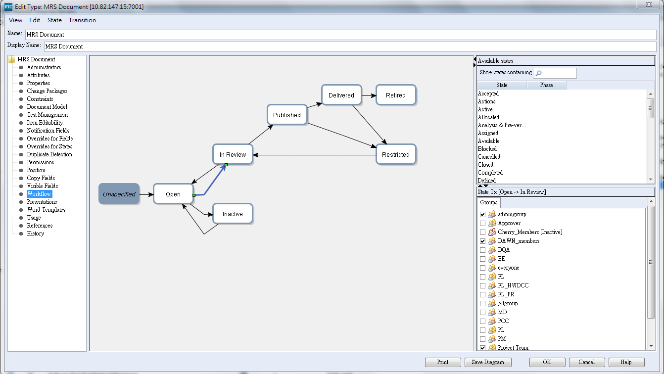

kjain-2
You can restrict a single user on workflow transition only you can use dynamic group method but this idea depends upon the Project like if you are working for that project only in that way that dynamic group work and you have to add those members whom you want to give access except restricted user o.w. there is no way to restrict a single user.

VolkerEckardt
Isn't it this?
kjain-2
Hi Volker,
Thanks for this information, actually this is better way for this but i took question in different way , i was on different track. Thanks Volker.
Regards
Kapil Jain
