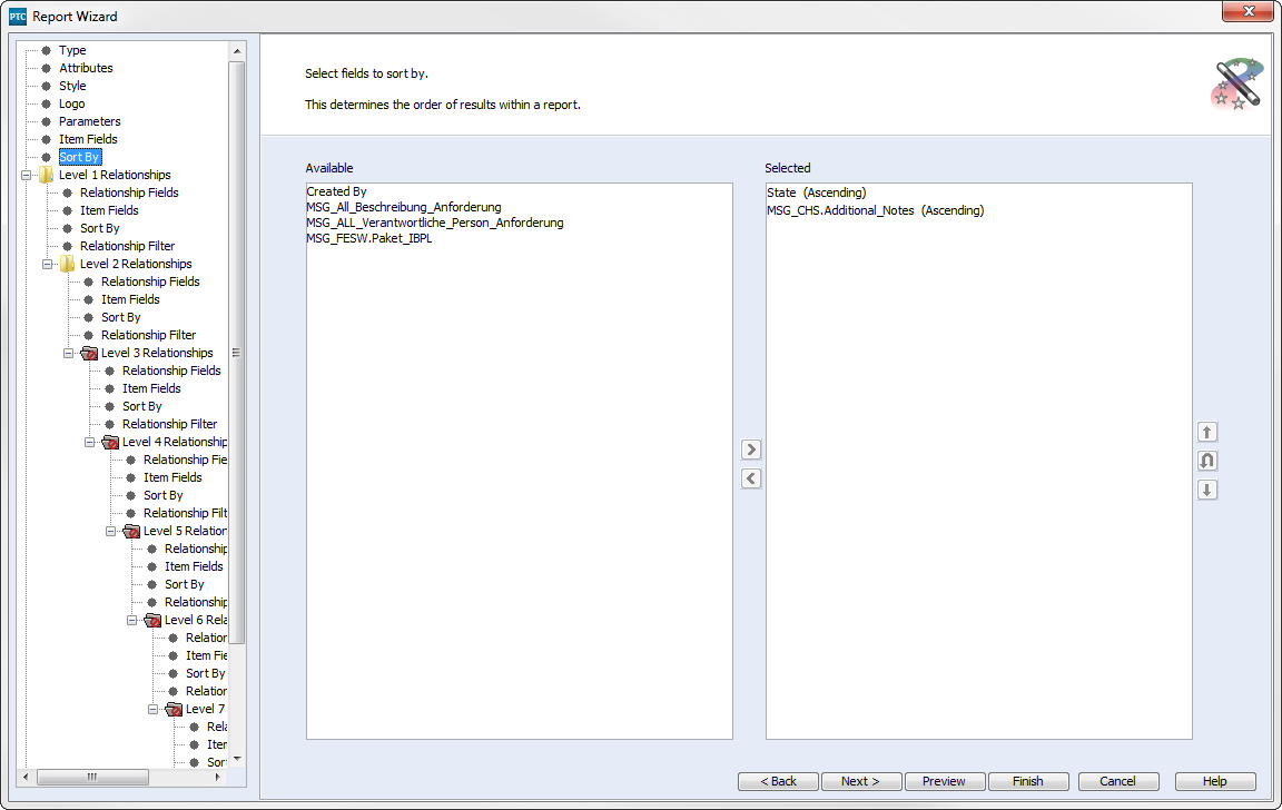

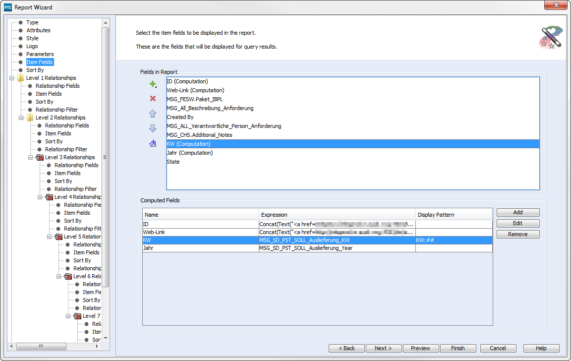

JensN.
Hi Gaurav,
in the following Screenshot you can see a list of ten fields which should be used in a report. Four of them will be manipulated by computations:
And here you can see, that only six fields are available for sorting: None of the manipulated fields is available:
kind regards, Jens
