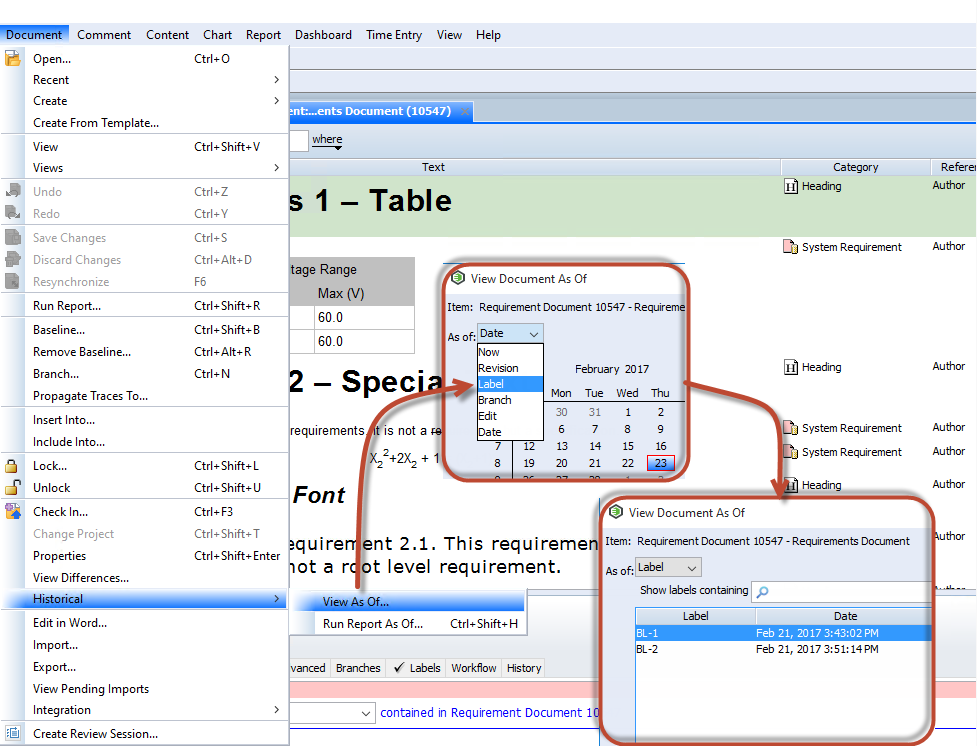

A document can be viewed at a specific date: Document -> View as of...   -Date selection
We suggest to add an option to view the label like it is possible at the Gateway Export wizard: Document -> View as of....  [o] Label = "XY"

Hello Daniel,
                    I was reviewing your Idea & I think there are multiple Ideas coupled into a single request. If I look at the summary it is "View Document as of Baseline XY" which is available in the current version of the Product. If you look at the snippet below, I think it has what you are looking for.
Please separate the other issues related to Version of Documents for Integrity Test Management into a different Idea so we can better track it.
