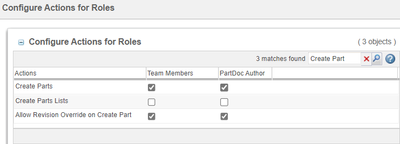

Logged on as admin, from an object (e.g. a Part), select Edit Access Control. This is not to edit / change the access but to investigate. It lists all sources of permissions here, allowing selection of groups / roles / individual users.
Best tool for investigating.
Actions on "PartDoc Author" role are set as-expected. --> RRAKOTOV_1-1713892522569.png
I will continue to investigate !

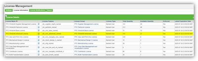

Check also the license applied to the test user.
Licensing is OK
--> "PTC Windchill advanced" is not fully used

  • License(s) applied to the user

  • "Configure Actions for Roles" set within the Product/Library
