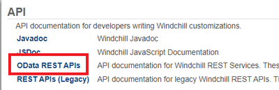

You can start with help documentation.
windchill_rest_services/r2.5.
Also each Windchill installation has documentation for OData REST API
https://serverAddress.company.com/Windchill/app/#ptc1/apiDocs/apiDocs
I have experience just with OData REST APIs because I use it in the ThingWorx .
I hope this can help.
